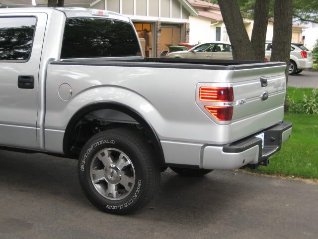

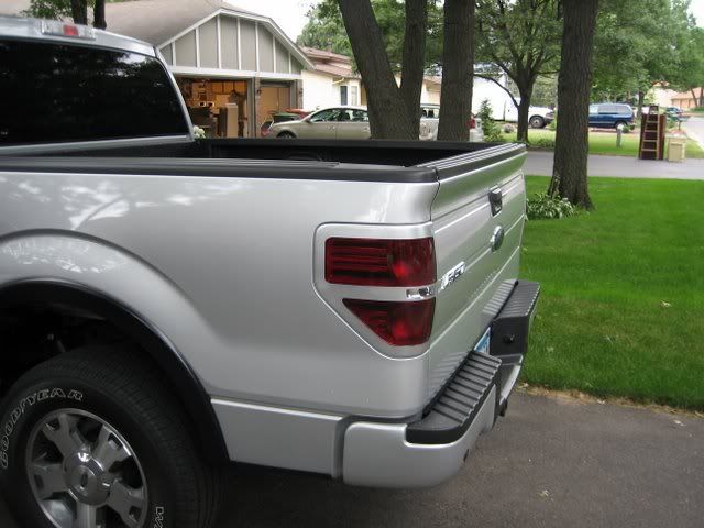

Well this weekend was a nice one to pull the tails out of my truck to tint the lens and paint the border.
Here is the finished product. We all know what the stock ones look like. This is also a good pic to show what it looks like when you remove the FX4 decal.

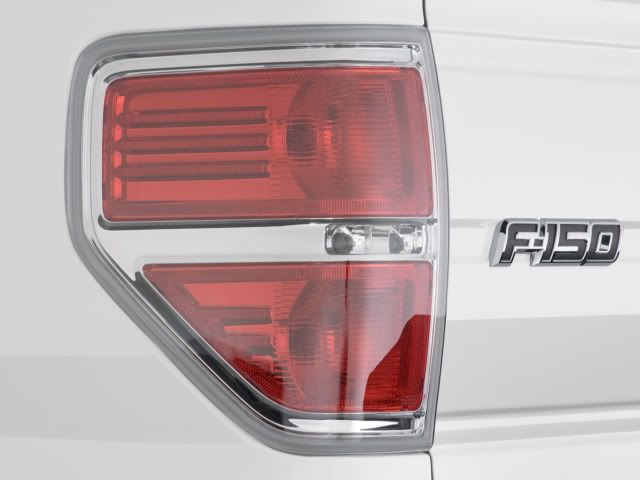

you guys don't know what stock looked like LOL here is a pic of stock.

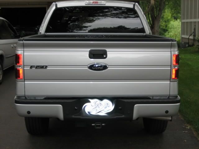

This is from the back.
Here is a good close up. I left the backup lens clear. I have learned my lesson when it come to that.
