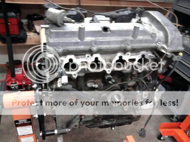

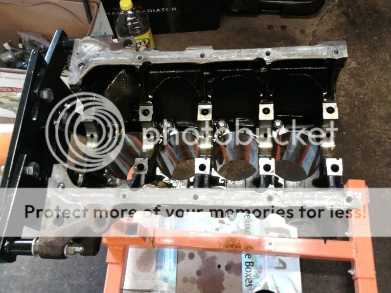

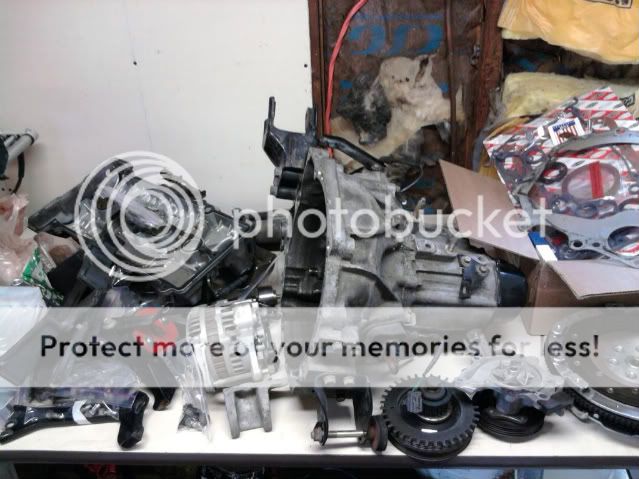

Had a productive morning today.
Turned this:
Into this:
And this:
Unfortunately the rest of my parts aren't nearly as neat and tidy as my pile of internals. The rest of my garage looks more this right now, haha
Wow, impressive work for the day! Have you come across anything that looks like it was contributing to the noises you were hearing that prompted this little project?
No smoking guns, but there were a couple signs that the motor was getting old. 3 of the 4 pistons had noticable scraping on one side of the skirt, and the rod bearings looked to be pretty worn too. I don't have the expertise to really make a diagnosis, but I suspect the rebuild is coming none too soon. I'll try and get a few better pics of the worn bits up tomorrow in case anyone wants to throw in their $0.02.
