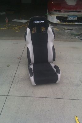

So 1st off, I ordered up these ^ corbeau seats along with the rails and harnesses and got those on the way so I can get a jump start on the interior.

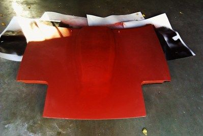

Secondly, started body work today with the cowel on the hood (figuring it'd be the easiest to kick things off with). Almost have the wooden frame done and should be ready to fiberglass soon.

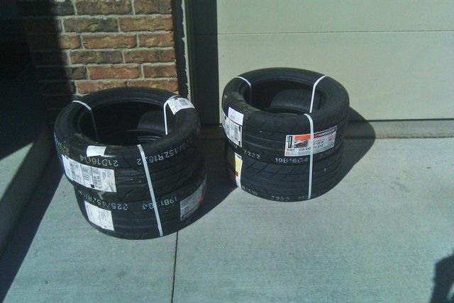

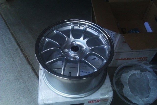

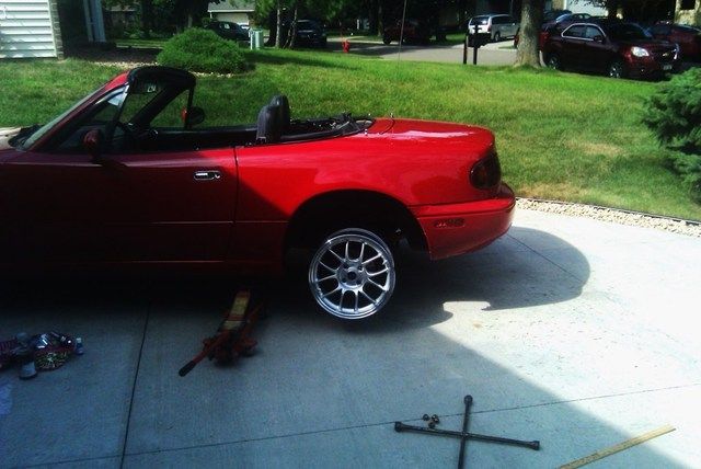

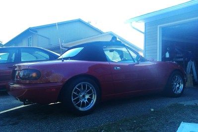

Finally... my wheels came at last!!!!!!
The tires will be in on monday and I can get them mounted and test run them.

The 15x9 +36s would have fit with a flat roll, no pull.
That's about the widest street 15" tire you'll find, though. :)
Looks good!
ohsixspeedsix
Owl Exterminator!!
Eh I would have. But I won't be producing THAT much power. And considring the price, I don't think I would have the the money back out of the extra inch.

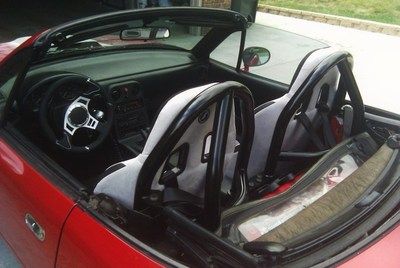

New parts ordered
Ordered new parts today.

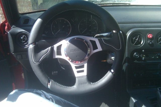

Momo millenium steering wheel and hub adapter.
Boss frog double maxx roll bar.
Oracle flush mount headlight kit.
Hopefully I can get AJ and Dan to give a hand on the bar since we all know the drill now lol.
I'm game for helping, but are you sure that's the one you want? I didn't think those made the Miata legal for track days.

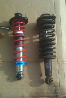

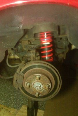

Some suspension shots. V-maxx coilovers.

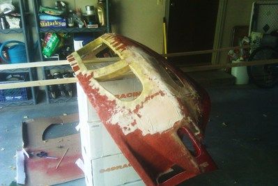

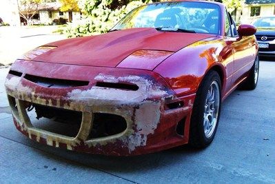

And some pics of the start of the body work.

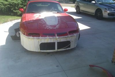

Mould for the front bumper:

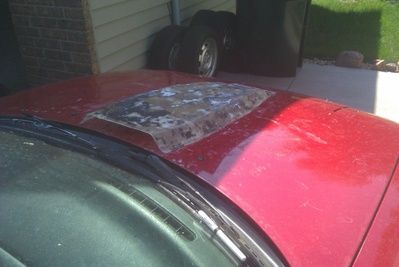

Bumper test fitting and started filling/smoothing the hood scoop

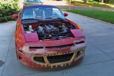

More pics of the progress on the body work

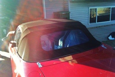

Got the new top on. One piece zipperless canvas defrosted glass window top.

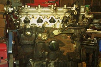

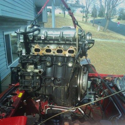

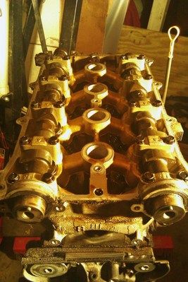

Who's ready for some engine tear down!?

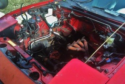

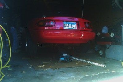

Pulled her in and got her up for a 10 hour tranmission removal.

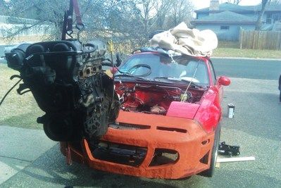

Then we rolled her back outside to pull that MONSTEROUS 1.6 liter.

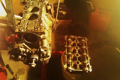

Now it was time to start stripping her down. Valve cover off and block started getting all it's bits removed.

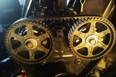

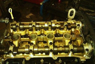

Dem cams
Head ready to come off?
Yep!
