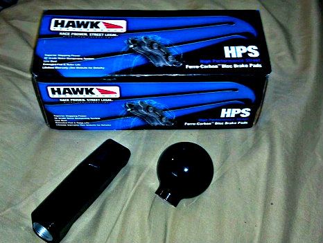

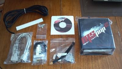

Update time. Ordered up the rest of the brake pads, 25mm spacers, and voodoo shift knob and e-brake handle. Those should be here Friday. Turbo and IC should be here late this week or early next week. This came as well:

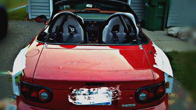

Body work is making sweet progress. Spent about 10 hours forming the mold for the drivers side so that it is perfectly symmetrical to the other side.

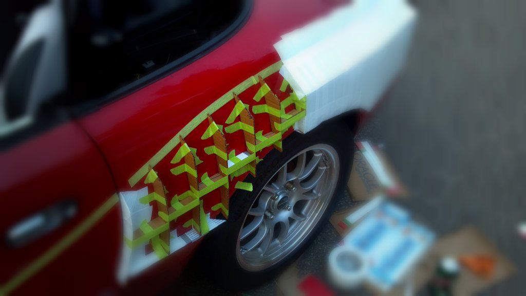

And here is a little view at the inner working of how to make them perfectly even. Lot of measurements and running back and forth between sides.

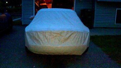

And under the cover you can see the extra width and shape.
